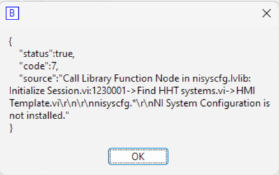

Hi, Scott. Thanks for your reply.
The Malware software is SentinelOne.
I am using the *current* version of NIPM, 2024, 64-bit.
FWIW, I'm attempting to install the LabVIEW 2020 SP1 runtime and system configuration packages on this brand new machine, in order to run a program that has been built on another (Windows 10) machine. This is not a new operation for us -- we've been doing exactly this for years.
I have previously loaded the runtime, and it's complete enough that I can run my app's .exe; its HMI paints correctly, but then it pops up a dialog box with a JSONized LV error object:
This is coming from our code, in response to an attempt to find possible cRIOs on the network to connect to -- in other words, attempting to use the System Configuration module, which isn't installed yet.  So far, so good.
I then tell NIPM to install the System Configuration module, version 20.5.  After I approve all the licenses, it says:
Wait, what? It wants to install the *2019* Runtime, presumably as a prerequisite to the 2020.5 System Configuration. I infer that somehow NIPM doesn't actually "see" the 2020.5 runtime.
