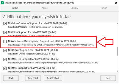

This has been such a pain I wish NI would fix this.
Uncheck the box:  NI Web Server Development Support for LabVIEW xxxxx xx-bit
After that things seem to go just fine.
