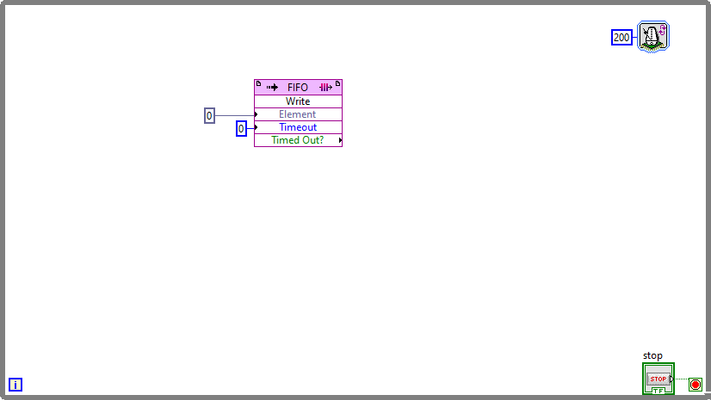

In essence: i have a problem related to the FPGA DMA FIFOs when i use Target to Host type FIFO (sending data from FPGA to RT).
In order to explain the issue in the most simple way here i'm posting a simple example with a FPGA vi that writes every 200 microseconds and a RT vi that reads 1000 data points.
FPGA
RT
When i run the RT code, it should read 1000 data points every 200 ms. However, as you can see in the following chart related to the RT vi, the elapsed time goes to 201 ms periodically:

Thanks for the response.
However i have some points to make:
  • RT code has plenty of time to run. Between two consecutive reading operations we have 200 ms which should compensate for code jitter inside the loop.
  • If i set a timed loop in RT to run at 200 ms, the behavior is the following: the cycle runs in 200ms but the reading alternates between 1000 and 999 points. So it seems that 200 ms, sometimes, are not enough to have 1000 points available, which is strange because FPGA runs at exactly 200 microseconds
  • I used the exact same procedure last year and the behavior was different (i remember it working as i expect it, without those 1ms delays). Could it be caused by new version of the RT Linux OS or the FPGA firmware?

Yes.
I remember that in previous tests (last year) the timing was as you have described: the cycle run at 200 ms with rare peaks at 201 ms immediatly followed by 199 ms (catching up).
The behaviour i'm seeing now is a bit problematic. These delays always over the 200ms will cause serious drifts over long times.
EDIT:
Doing the time checking in microseconds i got this:
There seems to be a somewhat random pattern but with an offset (the medium value is above 200000 microsecond).
There is more or less a 70 microseconds constant jitter..
(3,645 Views)
Accepted by topic author Mattia88
After a bit of work and cursing i think i solved it.
The problem is related to the NI softare installed on the cRIO. After re-installing the recommended software (NI compactRIO 18.5 - january 2019) without any custom modification.
Moreover i think is the version of the RealTime or NI RIO that were causing the issue (maybe is related to the compatibility between those softwares and the FPGA firmware).
Now it works as expected.
Thanks for the support!!!
