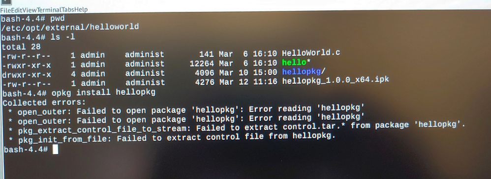

Thinking I might be invoking opkg install incorrectly using the entire filename I tried just
opkg install hellopkg and got the following:

Thanks for sending that information and your ipk. This behavior is very strange and I can't even get it to reproduce.
FYI, the second error is reasonably expected. opkg is trying to use the "hellopkg" directory instead of the ipk when you run the command (as there's no hellopkg ipk since the system isn't accessing our repos) and fails accordingly.
I've tried installing the xinetd-dev ipk after downloading it, and I get the expected errors on an offline system (missing dependencies). After that, I have no issue installing your ipk. At least there's the good news that your ipk works on my system without issue!
  1. Can you try running opkg update and the installing?
  2. Is there anything in the /var/cache/opkg directory? This should be cleared after each ipk installation. If there's something there, try removing it.
  3. If all that fails, try running opkg with an increased verbosity level for debugging purposes. E.g., opkg -V3 install <package name>. I'd recommend routing the output of that to a log file so you can see if anything stands out.

So when I run the opkg install its proper form to use the whole filename with .ipk, such that opkg install hellopkg_1.0.0_x64.ipk is valid?

here are three levels of verbosity for the install of the hellopgk_1.0.0.0_x64.ipk
Still getting the odd response from asking to install hellopgk that is referring back to xinetd - something is "stuck" somewhere it seems in the opkg side
