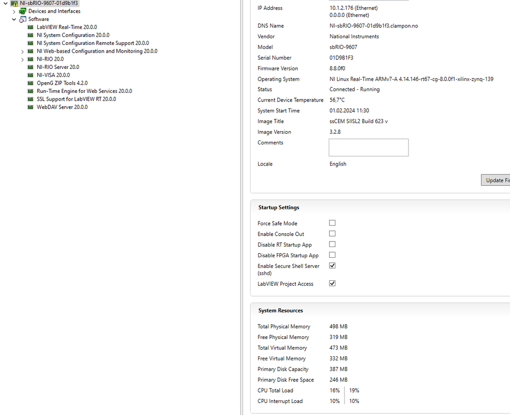

2020
With Firmware version 8.8.0f0 (LabVIEW 2020) the necessary firmware left 246 of 387 MB free...so the firmware took up 141 MB, as seen here:

    The software reported in NI Max on this device is:
I have not tried to do this on a target with a 2024 system image yet though...And I have not tried your recipe yet (the warned side-effects seem worse than for what I tested, but then I do not know fully what the effects of my changes are 😨...).
