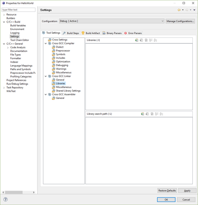

Haris is correct. You can also do this in Eclipse (though it's a bit of a pain) in the project properties.
  1. In Eclipse, open the properties for your project.
  2. Navigate to C/C++ Build >> Settings.
  3. Select the Tool Settings tab and then Cross GCC Linker >> Libraries. You should see the following:
  4. In the Libraries view, click to add a library.
  5. Enter the name of the external library you wish to link (e.g., udev) and click OK.
  6. Repeat the above for each library that will need linked. E.g., you could add c as Haris mentions to manually link libc.
  7. Click Apply and OK to apply the settings and close the project properties.
  8. Rebuild your shared library.
Charlie J.
