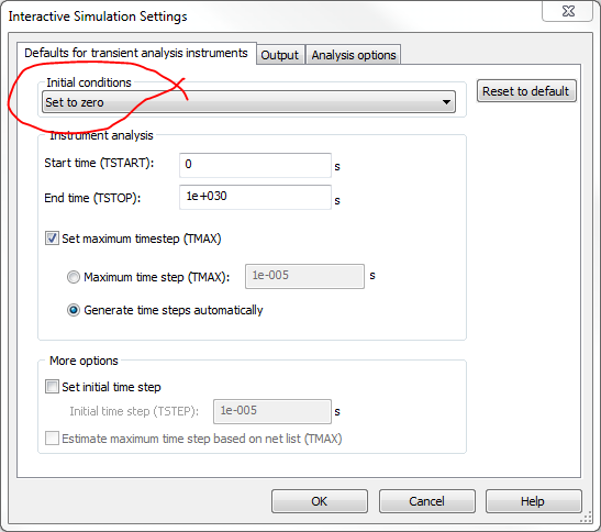

You can set the initial simulation settings to zero under Simulate > Interactive Simulation Settings > Initial conditions.
I am not familiar with the option parts after screen? What is the effect of this setting?
