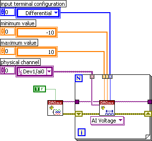

I'm using a data acquasition/file writing VI that I wrote myself to sample voltages from an experimental setup to measure the index of refraction of several gasses at various wavelengths. The experiment itself isn't that important. Anyway - I'm using the DAQmx version rather than the DAQ Assistant because the Assistant can't handle the number of samples I'm taking - LabVIEW runs out of memory.
I have three voltage inputs into a PCI-6115 board - two correspond to voltages from two photodiodes and the other is a voltage from a pressure guage. The Voltage envelope from the two photoditectors is about +/- 2 V while the pressure guage goes from about 7.5 to 0 V. In order to accomodate voltage readings from all three channels, I set up my VI to take voltages from 7.5 to -2 V. This is far from ideal. Is there any way to set up modify the VI I've attatched to so that it has different max/min voltage readings per channel? Yes, I could just use two of the VI's with different limits, but it's important that I get three simultaneous readings, I don't want the pressure sample to come at a different time than the photodetector voltages.
The VI I've attatched is contained in a for loop and a sequence structure, it is the last frame of the sequence structure - I just figured it'd be easier to understand if I just sent the data acquasition part along.

If you mean you could use two different DAQmx Create Channel functions on the same task, then that will not affect sampling. If you mean you could use two different tasks with two different DAQmx Reads, then you can't do that. Shown below is a DAQmx Create Channel inside a for loop so you would have arrays of channels, ranges, configurations, and each can be different.
Also, you should not be placing all of your attached code inside a for loop. There is no reason to be creating, starting, and stopping a task with each iteration. You also mention a sequence structure. You might want o think about ways to eliminate that. Use dataflow to control execution order.
