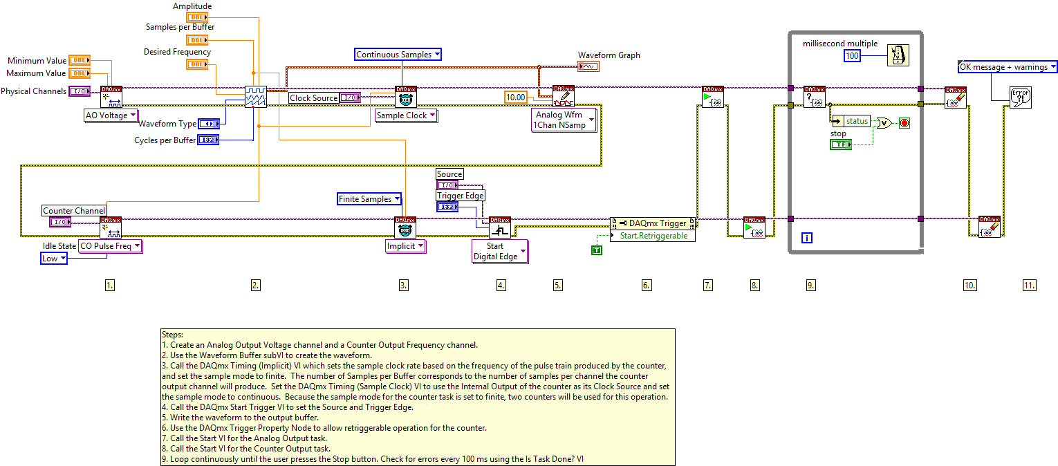

Hi David,
1. When I go to the NI-DAQmx C Reference Help section for the PCI 6733: http://zone.ni.com/reference/en-XX/help/370471W-01/mxcprop/attr190f/ it explicitly lists Retriggerable under NI PCI-6733 Supported Properties...
Is this the page you meant? http://zone.ni.com/reference/en-XX/help/370471W-01/cdaqmxsupp/pci-6733/
That page lists all of the properties supported by the PCI-6733, but not which channels support them. Start >> More >> Retriggerable is only supported for ctr0:1.
2. When I look at the hardware corresponding to the instructions you linked me to: http://zone.ni.com/devzone/cda/epd/p/id/4787, the PCI-6733 is NOT listed among the hardware models.
You're right, the list of hardware models on that page is missing some devices.
3. When I communicate with the card via matlab's daq toolbox, it furnishes a property called "TriggersPerRun" that I can set to Inf to achieve re-triggering. I suppose matlab could be facilitating this via the counter output function, but it just seemed unusual to me.
I'm afraid I can't help you there.
Lastly just to make sure I am understanding the support page you linked me to properly well enough to pursue python implementation-
Sorry, the web page doesn't have all of the details. Here are screenshots of the VI:
Key points:
  • On the AO task, use continuous mode and use "Ctr0InternalOutput" as the sample clock source.
  • On the counter task, configure a start trigger and set retriggerable to true.
  • Start the AO task before the counter task.
Also, 3019.zip on http://zone.ni.com/devzone/cda/epd/p/id/2345 demonstrates retriggerable AI in C/C++, which might be helpful.
