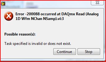

I have the latest updates for LabView student edition and DAQmx for acquiring data from my USB 6008 and I also have an analog 3V input wired to the 6008. The USB 6008 appears to work because when I run a test panel in measurement and automation explorer, it displays the voltage input.  I’m trying a very basic vi in LabView to graph an analog voltage using the DAQ assistant but I get the following message when I hit run:
Any ideas on what I can try next?

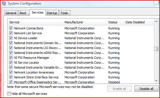

Hi Bryan,
This generally happens when the driver can't access certain services associated with NI software.  Do you know if anyone went through and manually stopped services?  Could you run msconfig from the "Search Programs and Files" in the Start Menu and post a screenshot of the NI services that are running?

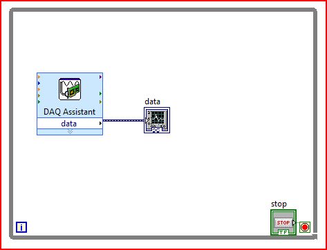

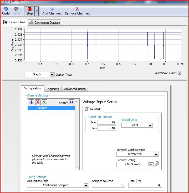

I'm including a screenshot of the block diagram, msconfig for the NI software and the DAQ assistant configuration.
Thanks---
Message 6 of 17
(7,405 Views)
It looks like you are missing the NI Configuration Manager service.  Could you try repairing your DAQmx installation and seeing if that fixes the problem?

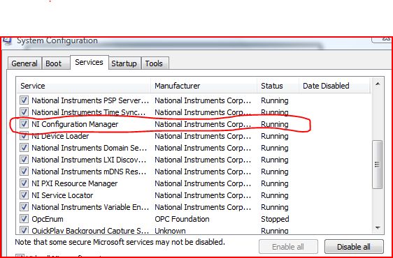

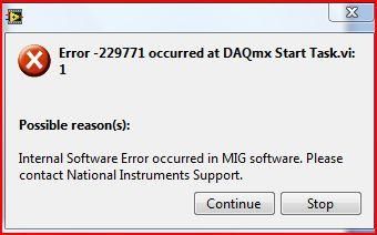

Seth,
I don't think the NI config manager was showing in the area I had scrolled to. Here is the complete NI display. I'm also showing another error that pops up when I hit run.
