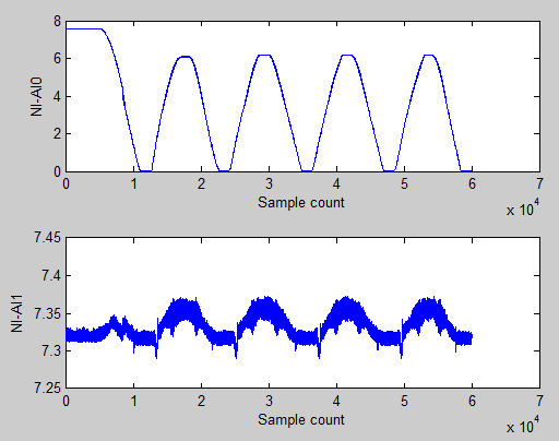

Here are the effects of changes in a channel (NI-AI0) on the channel next to it (NI-AI1).
Note:
1) Channel NI-AI1 was held at a fixed voltage in each experiment. (but not necessarily accross experiments)
2) Axis between plots are not scaled. Please pay close attention to the ticks.
This is what my non-buffered raw signals look like
Buffers are improving the results but they are still far from acceptable. ( Connection diagream can be found in earlier posts of the thread)
a) Using OpAmp - LM2902N
b) Using OpAmp - NE5532N
Matlab figures are attached for examination
Message 8 of 51
