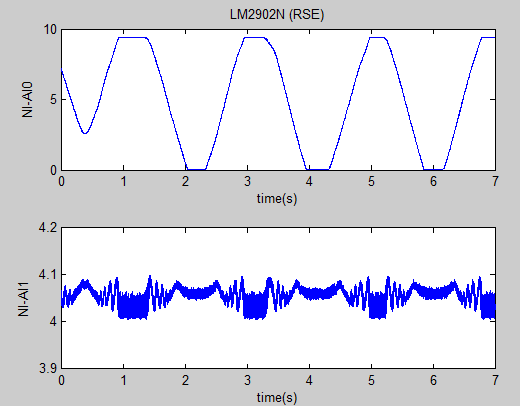

Not much of a difference. Here are the plots. Data and Matlab figures are also attached.
