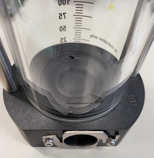

Concerning the reservoir, it is indeed a glass vessel containing the liquid to measure but it also has a pressure-based level sensor built in its base that is connected to the rest of the system via a pressure transmitter. The inlet and outlet are also both in the base:
I also tested measuring the same solution in a glass beaker in close proximity of the TFF system and in the reservoir with the power supply of the system disconnected and in both cases the measurements were stable and precise.

Regarding the reservior: It doesnt seem to be grounded since all parts are glass / plastic, hance electrically floating.

Thanks as always for your response. That's what I assumed as well regarding the reservoir. Concerning the pump, I haven't tested controlling it manually but I would assume that the signal would behave similarly like in the previous graph I posted here:
