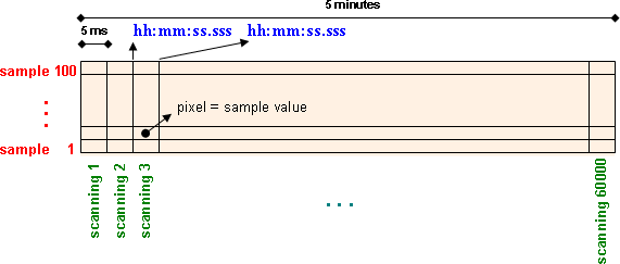

A research group has developed a data acquisition system of solar radio waves. A spectrum analyzer (HP8559-A) sends sync and data signals to the USB-6009 connected to the PC. The falling edge of the sync signal indicates the start of a scanning. When a start is detected, the analog data signal must be digitalized during 5 ms until the next rising edge (Figure).
A software must acquire 100 samples of the data signal per scanning and store samples on a file during 5 minutes. When the acquisition ends, other acquisition restarts storing samples on a new file, and so on, for several hours until the user stop the execution. After, each file will be visualized as a solar data image (Figure).
Current Software
A previous developer sets up the DAQ task in order to acquire samples of sync (Dev1/ai0) and data (Dev1/ai1) signals in continuous mode, with sample rate of 20 kS/s during 5 minutes. Sync and data samples are read and stored on a file. After, invalid data samples (when sync samples is in high level) and all sync samples are removed of the file. A new acquisition restarts on each 5 minutes, and so on until the user stop the execution. This acquisition software is operating successfully. (see code attachment)
Data Acquisition with Timestamps
However, we need timestamp the solar data at the beginning (and, if possible, at the end) of each scanning. So I need get timestamp at the falling edge of the sync signal (and, if possible, at the rising edge) (see first figure).

Lilian,
The USB-6009 does not have a PFI output to generate a trigger signal for the PCI-1588, it could be done using the digital output by software, but the signal would suffer a little delay that would compromise the time stamps.
The best way to accomplish what you need is with NI-6010 or another card with PFI output to send the start trigger on the falling and rising edges to the PCI-1588 to get the time from the GPS and to start scanning and storing the samples.
The USB-6009 would not be used with your application. The trigger and data acquisition would be made using the PCI-6010.
