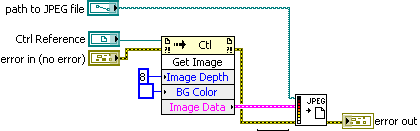

How do I programmatically export a graph as an image
How do I programmatically export a graph as an image using the elapsed time vi?

You use the Get Image method and wire the results to the Write JPEG File (or Write BMP/Write PNG). On your Report Generation palette, you can look at the Append Control Image to Report function.
