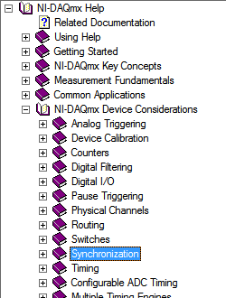

The 10MHzRefClock signal only currently applies to the 6124, 6154, M Series Devices, X Series Devices, and SC Express Devices.  Device-specific information about synchronization methods can be found in the DAQmx Help:
                19111i313C635FF8FDC12B
If you're trying to synchronize the PCI 6110 to the PCI 6115, the best bet is to use RTSI and share the 20 MHz timebase between the two.
