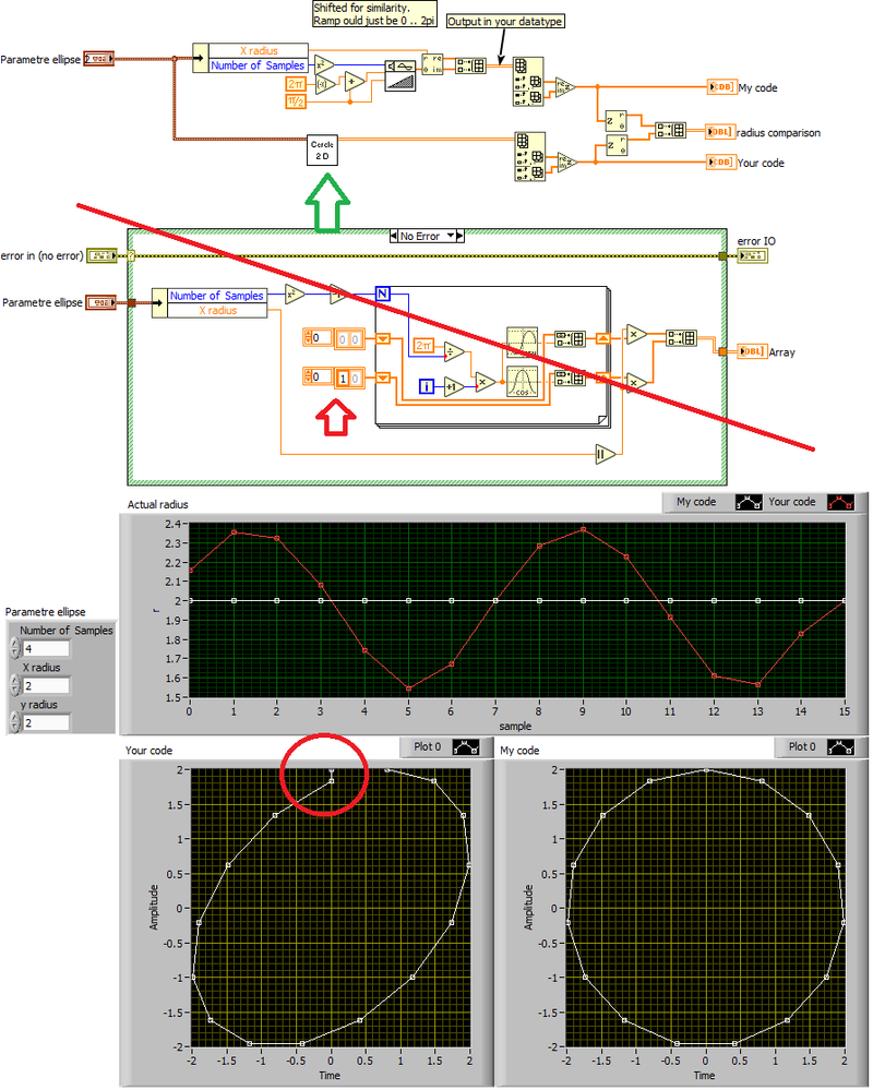

I am pretty sure that your ellipse (which is a circle because you ignore the y) is buggy, because it only converges to a circle for very high point counts. As you can see, the actual radius fluctuates because one of the shift registers starts with a non-empty array, so the first point is an "almost" duplicate of the second point. (Note that if you don't want to close the circle, you can change N and set "exclude end=true" for the ramp.)
A circle is most easily done using a complex datatype. The tiny code on top does the same (and better!) as your entire subVI.
(Most of your other code could be corrected similarly.)

Thank you very much, Altenbach, for looking at the code and for your advice. I will make the changes and check to update the rest of code.
I will see what impact they have.
