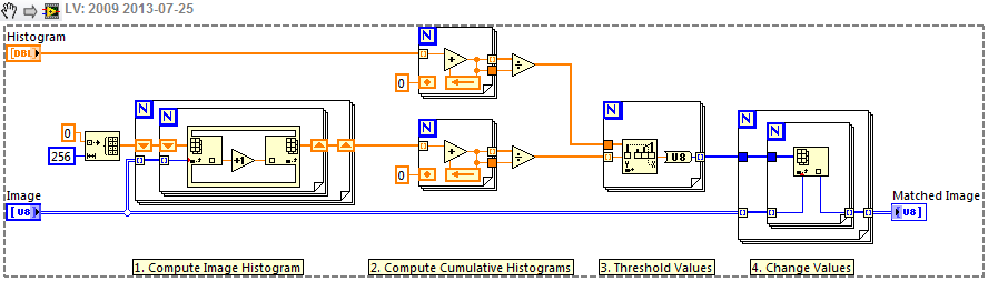

The OpenCV solution is a good one, but may be more complex than you need for a simple greyscale image.  It is pretty simple to write your own:
1) Compute the cumulative histogram H0 (or histogram integral) of the histogram that you want to use and normalise
2) Compute the cumulative histogram H1 of the image you want to match
3) For each value in H1, threshold H0 to find the matching index
4) Compute new image values from the matching indices
You could of course compute the histogram of a second image if that's what you want to match to.  I've used this technique to "equalize" the histograms of a large number of images to the mean cumulative histogram of all of the images.
