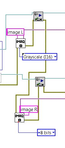

Attached is my VI (using labview 8.5) and am not sure where it is getting the color info from, but it saves the image as jpeg/bmp/tiff with colormap (confirmed by imread in matlab). Can someone help me save these images without colormap info.

So in the example you posted the image type being provided to the 'IMAQ Create' VI looks like it is being coerced from '8-bit' to some other type. This typically happens when an image type is selected that is not compatible with the current video stream. I deleted the 'Image Type' constants wired into the IMAQ Create VI and replaced it with a fresh control which then correctly displayed the compatible. When you set the IMAQ Create VI to one of these other image types do you still see color data in the final saved image?

Can you explain as what you mean by creating the control again? Do you mean to recreate IMAQ create again and redo the connections for the image type terminal? If that is the case, I tried that and it still shows a red coercion dot. Do you have any other suggestions on this issue?

Take a look at this screenshot for an illustration. I deleted the image type constant connected to the image type terminal of the top IMAQ Create VI and replaced it with a new constant. This changed the available image types and removed the coercion dot.
Let us know what happens when you try to save images using one of these formats.

When I try a different image format, like 16 bits, Float, Complex or RGB chunky etc. I get an error number 1074396078 in IMAQ grab acquire.vi
When I try Grayscale I16, the coercion dot still appears, but does not give an error. Although it still saves the image with color map.
I just checked that I am running my program in labview 8.5 but am using the labview 6.5 version IMAQ create. Does this have anything to do with the image types available for IMAQ create?
