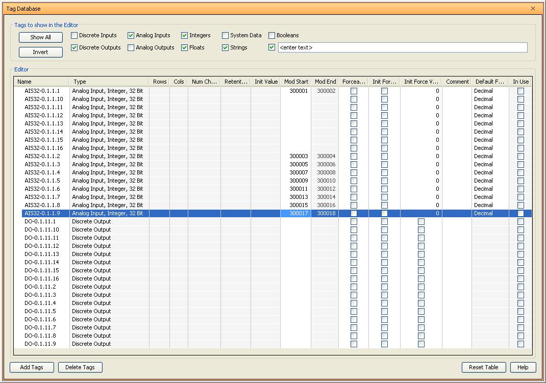

I received the following from Kepware support after I asked about the automatic tag named database like I can do with Controllogix;
"We do make a version of the server for NI, you would need to make sure it has the Modbus suite installed. As for tagging, we cannot import like we can for the CLX driver, so yes you would need to configure the tags manually or via a CSV import, or you don't have to set them up in the kepserver at all if you do not want to, from NI you could address them as Channel.Device.Adrress@DataType."
I am proceeding with the NI Lookout Modbus driver and not using OPC
In the Pro 3000 softwareI have auto-assigned 300001, 300002 to the first analog input.
I have created a Modbus ehternet object and it is communicating in Lookout.
I then created an expression; Modbus1.300001
It does not work.
Here is the analog channel in the Pro 3000 software;
22198i60FCDC5E2120A1E0
Message 7 of 9
(7,650 Views)
If the PAC series is like the original DL series, you need to add 1 to the address. 30001 becomes 30002, etc.
Mike
Forshock - Consult.Develop.Solve.
Message 8 of 9
(7,648 Views)
Thanks Mike -- that did not work.
I realize the 16-bit input maps to two registers so I was hoping what you said would work.
22204i3E9ED3ED525A39F3
Message 9 of 9
