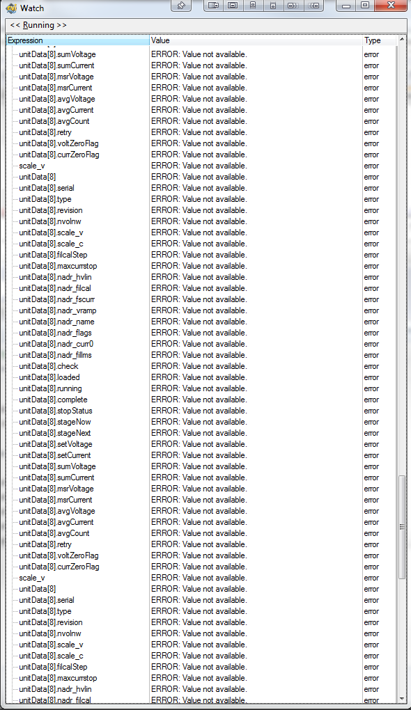

I've added a few variables to the watch window and upon each debug config compile, the watch window is stuffing itself with duplicates of this variable.  See attachment. As you can imagine, this project is getting slower and slower to debug.  And there's no "select all" feature in the Watch window to remove them all.

Hello ElectroLund,
Could this be the same issue as in this post: http://forums.ni.com/t5/LabWindows-CVI/duplicate-watch/td-p/2893688 ?
Constantin

Ah, yes you are right.  I had searched before posting, but didn't find that one.  Thanks!

not sure that I am doing anything different to previous versions of cvi which I have used for many years.
In debug mode,
set breakpoint to stop where required.
highligh the variable or structure to watch
click the "add watch expression" button (glasses with (a-b) beneath), this adds an instance to the watch window.
several iterations of running the porogram later I end up with a screen full of duplicate variable is the watch window as previoulsy described in this post.
