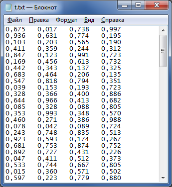

This sample generate 4-column file
If you want work with excel you need LabVIEW Report Generation Toolkit
