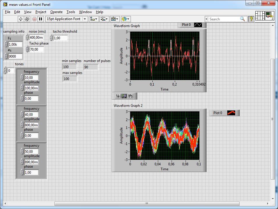

Homework?? However ..
Greetings from Germany
Henrik
LV since v3.1
Message 8 of 24
(9,141 Views)
ups there was a bug in that quick shot .....
here the corrected version ...
Henrik
LV since v3.1
Message 9 of 24
(9,137 Views)
