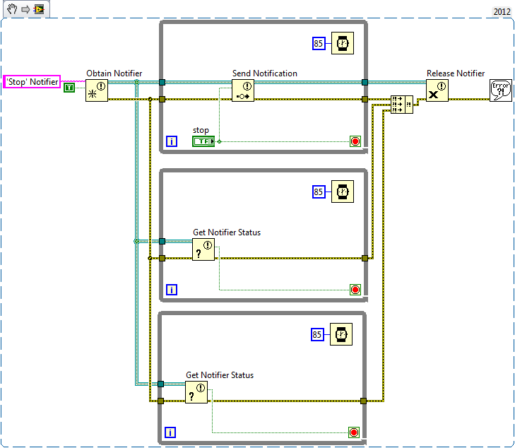

timer function till some boolean become true
I want that a loop waits till some boolean from another loop becomes true.
Is it possible to make it with a kind of timer?
Thanks in advance

Why a timer? You could use an event structure with a user event. You could wait on a queue or a notifier. These are preferred methods for waiting for data from another task.

As Mark mentioned, here's how notifiers can be used to do what you want:
notifiers_snippet

Just don't (ever) name those Notifiers (nor queues)!
Naming them will essentially create a global. Nothing good will come from it. Unless it should explicitly be a global, do not give them a name. At some point you want this behavior twice. So you make the VI\code reentrant. Now you have two unrelated VIs communicating with each other.
Give the constant a label. That will show up in the probes. The name of the Notifier doesn't do any good, and a lot of bad. IMHO, but I've seen it go sour quite a few times.
I've seen libraries that used "Main" as queue name. And then 3 people searching for hours, because their template names queues with VI name - ".vi". They named their main VI Main.vi...
Just be warned...
