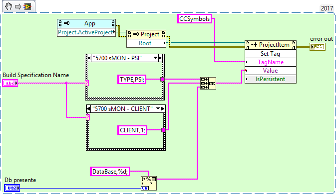

I would like to build two different versions of a distributed executable. (LabVIEW 2018, application builder, Windows 10).
One version (for selected users only) should be able to do everything.
Another version (for other users) has a restricted feature set but is about 98% of the full application.
It should not be possible for a user of the restricted version to gain access to the full features (so no configuration file or run-time settings or secret keypresses) - I expect there to be two distinct but similar compiled executables.
I would like to maintain only one set of code and not have to edit the source to change between builds. I thought of doing this with two different build specifications but I am not sure how to get the build option into the compiled code.
Is there a standard way to do this? Maybe include full.vi in one build and restricted.vi in the other? What is the best way to build in a compiled option?

Hi bean,
what about using conditional disable structures with project variables?
This way you can easily create two versions of your executable…

I too suggest the conditional disable diagram structure.  You can have two projects use the same source, and each project set a different flag when changes the software's behavior, and load different UIs if you want.

Thanks GerdW,
A conditional disable structure does what I need but I need to be able to have a symbol definition set in the build spec. That's the bit I haven't yet found. Is there a way to do that?

The conditional disable is fine - but how do I have different conditional disable symbols based on the build spec. As far as i can see they are common throughout a project and not able to be different in alternative build specs?

Just change the conditional disable value between builds.

Yes, there is a way. Here is an example taken from one of my projects.
AFAIK it's an undocumented feature (at least it was when I started to use the Set Tag method).
However, it works.
