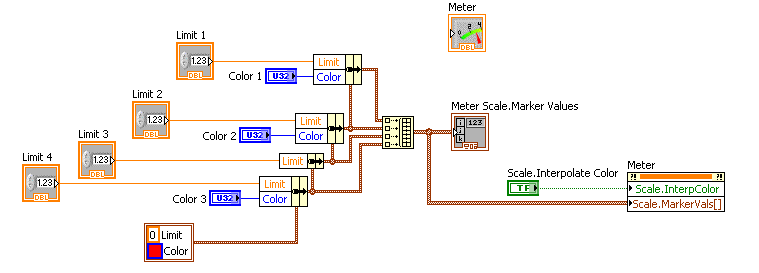

a meter is a nice indicator. I always change its colors by setting two properties:  Scale.Interpolate Color and Scale.Marker Values[].
LV 9.0 example is attached.

Ljubo,
I love this idea but I'm not really sure I know how everything works since I haven't done much with the property nodes before. Is there any way to save your .vi back to version 8.2 so that I can access it?

Hi Scott,
I'm sorry but front panel screenshot is everything I can do now.
Regards.

That helps a lot, thanks!
