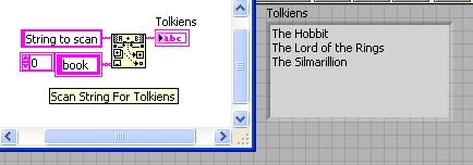

scan tolken string
OK I have been working with LabVIEW for many years and I have never understood the Scan strings for Tolkens.
Attached is what I expect, and what I am getting.  Please set me strait once and for all.

I've never used scan token string before.  Looking at the Context help and examples for it, it looks like it is meant to break up a string by the tokens, and is most useful if it is in a loop.  In your case, you are trying to find a string "wrapped" in your token.
I would use Search/Split string or Match Pattern to find the quotes and strip them out from there.

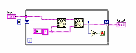

First of all, you're looking for the output from the wrong place.  "String out" is an unmodified copy of the input string.
"Token out" is the response you're looking for.
The first iteration will find your starting " as adelimiter and deliver the part of the string up to but not including the " character.  The second time you call the function (wiring through the returned index from the first run) it will give you the text between the first and second " which is exactly what you're looking for.

Just in case you expect more than 1 string between tokens 🙂
No one asked for it, yet, but who knows what tomorrow brings Smiley Very Happy
