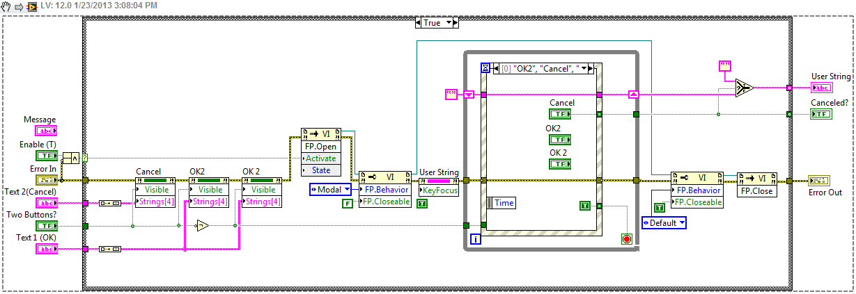

Its actually pretty common to use a pop-up dialog box to prompt user for input.  In fact its so common there is even an Express vi by that exact same name "Prompt User for Input.vi" which polls the users input.
Of course, Polling should be replaced by Events now that the Event structure is in all versions of LabVIEW so I keep an arsenal of these in my reuse code.
Smiley Frustrated Silly Snippett tool
"Should be" isn't "Is" -Jay
