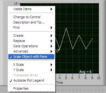

In LV8 open "Programmatically Annotate a Graph.VI" in
...\labview\examples\general\graphs
Right click on Waveform Graph and select "Scale Objecth Pane".
Run it.
Re-size window of VI by dragging right edge OR bottom edge.

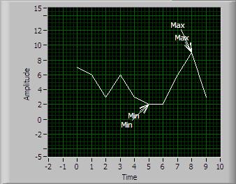

Toggle "Avg" boolean and observe artifacts.
It appears if the old annotations are not being erased before new ones a drawn.
Redraw returns to original style.

A similar issue had been previously reported, but I will forwarded this behavior to our R&D department for further investigation.  Thanks again for the feedback!

This was reported to R&D (# 3RRG44D1) for further investigation.
Thanks for the feedback!
