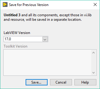

@GerdW wrote:
As has been said several times before: attach your VI, downconverted from LV2020. I still prefer LV2017…
Also, @jason888, in case you still want help, here's how to save to a previous version:
Thanks for the little programming challenge!
-joeorbob
