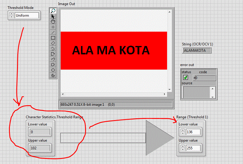

Hi
Just go to the LabVIEW code, read threshold rate from OCR and set a proper values on Threshold function Yoursel directly in the code (like something below).
Regards
Basia

Thank You very much Basia,
I think this can be the way to solution, but what if not "uniform" or "fixed-range" threshold method is used? I mean, if the image has a gradually changing characteristic in brightness, "linear" method sould be used. In this case the threshold range of the first character is different from the last. Correct me if I'm wrong but as I see You are using only the threshold range of the first character In your illustration, so the threshold settings of the ROI differs depending on where OCR process finds the first character.
What do You think?

Hi
Yes, Your right. But nothing stops You from taking all, or first and last value from an array and write a simple algorith, that will do whatever You want to do. You can take whatever data You need and use it the way You like - I just made an example - that's not a final solution.
Regards
Basia
