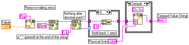

I've used the attached VI to do what you describe. I format the number, trim off all trailing zeros, check to see if the string then ends in a decimal point and if it does add back in one zero.

Here is a picture of the block diagram:  In the case structure, case 0.. is shown, case ..-1 is not shown but it is just a straight wire from input to output.  Same with next case, straight wire from input to output for case not shown "".
