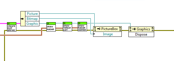

Darin,
I have taken your idea (with the re-paint user event) and have built a fairly elaborate radar type display.  In my event structure I put in a timeout (100ms) which contains my redraw code, this same redaraw code is also in the paint event case.  This works until another window or popup covers the picturebox and then the whole thing craps out and I have a big red X in the picturebox.  Upon examination I found that once the first timeout occurs, the paint event kicks in and continuously retriggers.  I would have thought that the paint event would only occur when the window resized or was overlayed.  Is there something wrong with my approach?
Message 4 of 10
(7,928 Views)

Hi Darin,
I think the problem I am having has to do with the way I am drawing to a .net bitmap instead of directly to the picturebox graphics canvas.
In my test code I send the final bitmap refnum to the PictureBox Image every 100ms, this works fine but have noticed that the act of updating
the PictureBox Image in and of iteself is creating a new paint event.  I would like to migrate my code to work like your example but all of my
drawing is within a graphics from a .net bitmap and the paint event seems to only contain the graphics from the picturebox canvas.  Any ideas?
Message 7 of 10
(7,858 Views)

@sachsm wrote:
Hi Darin,
The Image is the raison d'etre for the PictureBox, and updating its value is certainly a valid reason to fire a Paint Event.  The purpose of the event is to give you a chance to do some additional drawing or whatever.  I usually use it for text or shape overlays on an image.  The Image will always be updated.  This can be a cause of problems when dealing with these types of events, it is possible that an event will re-fire itself if you are not careful.  If you update the image in every paint event, then every paint event will fire another paint event, and so on.
If you are generating a bitmap image then it seems to me you could simply pass it on to the PictureBox when it needs to be updated.  No need to deal with Paint events.  This is a hand-rolled version of double buffering where you draw an image behind the scenes and then pass the finished image on to the display.
I guess I am missing something in your implementation.
