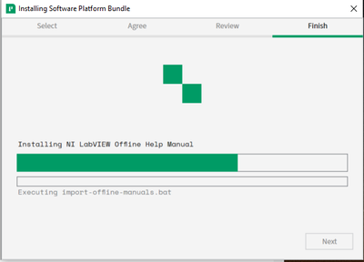

Hello, during the installation of my Labview software, the installation program stays in the process of ''Installing NI LabVIEW Offline Help Manual'', the square in the interface is still moving, but the progress bar does not move.
I uninstalled and tried again, but the result is still the same, what should I do?

When the install is hung, can you see in Task Manager if there is a process that is running NIOfflineHelpViewer.exe?
If yes, this is likely trying to register that executable as an EXE server. You could try to kill that process to see if the installation continues. You can do this in Task Manager or on a command prompt using the command "taskkill /IM NIOfflineHelpViewer.exe".

Accepted by yxm123@@
Yes, the Task Manager is running NIOfflineHelpViewer.exe.
The installation is continuing, your suggestion was correct, thank you very much.
