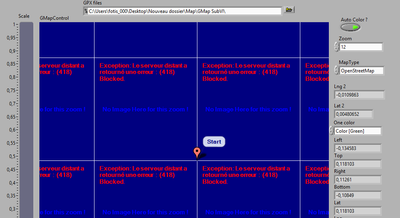

Thank you for your intersting topic. I have a problem with running the vi.
would you please tell me what is it problem for? P.S:I have used Labview 2020 Running on Windows 7 X32 Best Regards

If you ask about the problem that the map cannot be displayed here. There are two reasons for this. You have not chosen whether to upload a map online or offline. Second, some maps cannot be supported.

Google Maps:
Google requires you to get an API Key to use Google Maps API. This was not required earlier it was introduced sometime in 2019 or so.
https://developers.google.com/maps/documentation/javascript/get-api-key
See attached on how to apply the API KEY.
