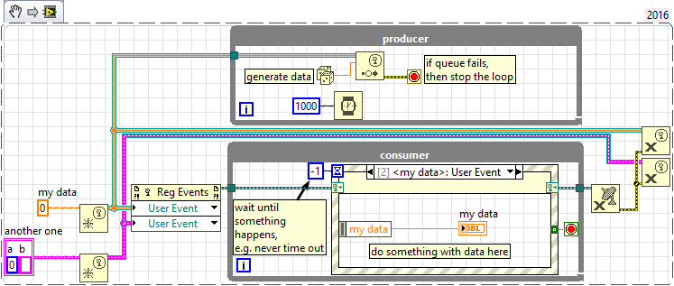

producer-consumer design pattern separates data acquisition from presenting/acting-on the data. it is like a template of good software architecture for this kind of problem.
the event structure can be used for reacting on GUI events like clicking a button, as well as acting on self created user events (this works like a queue, where the event structure can react on messages).
this helps to make it clear where and what you do in regards to user interaction.

a very simple example:
NOTE: this is a snippet. if you save the .png on your computer, you can then drag+drop it onto a block diagram (directly drag+dropping from the image in the forum does not work anymore unfortunately)
