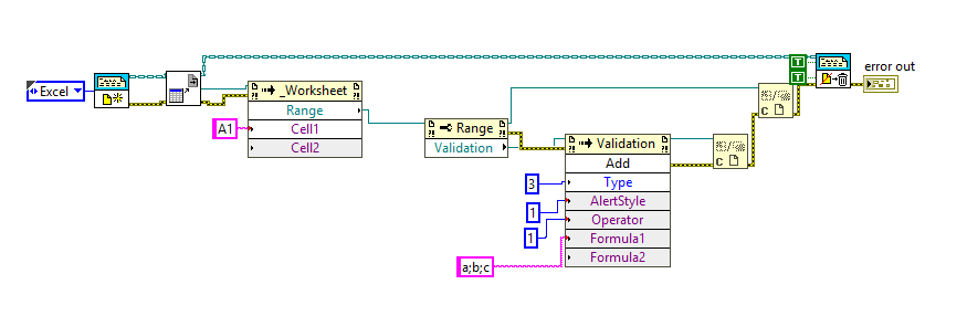

@Emna20 I think the OP wants to use LabVIEW to create a combobox in Excel, not to populate a combobox on a LabVIEW FP.
@alii001 In Excel, do you mean a form control Developer - Insert - Combo Box (Form Control), an ActiveX control Developer - Insert - Combo Box (ActiveX Control) or the drop-down list available from the right-click menu of an individual cell, sometimes called a data validation list?
Message 3 of 8
(4,518 Views)
This might be useful if you're trying to use a data validation list.  A description of the parameters for the Validation.Add method can be found on the Microsoft web site.
Message 4 of 8
(4,513 Views)
Accepted by topic author alii001
hi ,
add (true to wait until printing completed ) and (true to Save changes ) .
