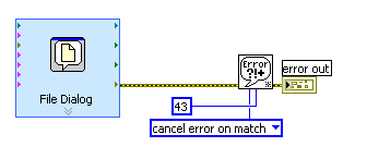

When I open a file using the Programming>>Files>>Adv File Funcs>>File Dialog I get an error if I hit cancel instead of opening a file or folder as expected.  I understand that there is a boolian (Canceled) available as an output of the File Dialog, but I need help figuring out how to use it to stop the event containing the dialog...and avoiding getting an error message.
The dialog is contained in an event which executes when I hit a "get a file to analyze" button.  If I don't stop the event from running if the Dialog is canceled, some of the other functions through errors related to Not an image file or the like.

I don't know what your code looks like, so I can only provide a general answer. Basically, you can enclose the code after dialog in a case structure driven by the "cancelled" output.

What about this?
Just cancel the error based on error number.  It happens that the error number for cancel is 43.

You do get an error. Put an error out indicator on the output. You've probably got automatic error handling turned on. As to why that's not triggering, I can't say - I never use that automatic error handling stuff.
