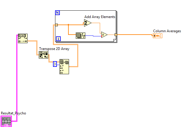

i want to get in the column averages just the average of the values of some columns not all the columns of the table.what i have to change exactly in this block diagram.even if the size of the table is 25,i want the division to be the number of values in each column(= number of rows)
just like that:

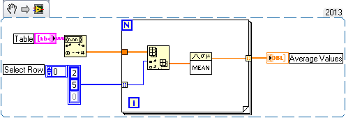

Check for "Mean.vi" in Mathematics palette. Replace your code inside the for loop with that vi.
Something like this you should have.

For that you have to index the array like this.
I would recommend you to go through some basic training materials in LabVIEW which you may find here.
Good luck!

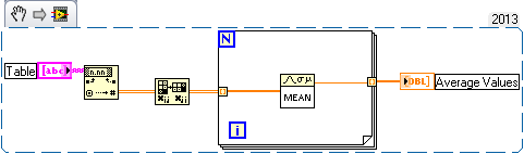

I didn't use a Transpose array Smiley Wink
Message 6 of 23
(5,990 Views)
if i don't use transpose array i will get the average value of each row, i want the average of columns Smiley Sad
