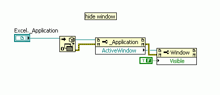

I've been using ActiveX with excel files and I have a problem trying to hide a Workbook on the "windows taskbar".
I can hide excel application and worksheets too... but I can't hide a workbook.
Example... I want work with 3 excel Workbooks (files):
Workbook 1: Materials.
Workbook 2: Measurements (hide this file on the windows taskbar)
Workbook 3: Costs.
WB 1 and 3: Visible (normally with excel application)
WB 2 NOT VISIBLE to the user. How can I do that???
Thank you...
Message 1 of 12
(7,732 Views)
what you can do to hide it is use the ActiveWindow property, and set it to false (see attached picture).  You may see a "blip", as you will have to acivate the workbook and then hide it, but it should work.

Hi...
Kenny K... thank you!!!
I Could make some "experiments" and it works great !!!
Best Regards.

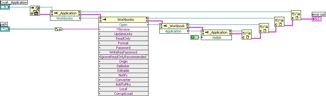

Hi Zicoozzis:
You can also hide the particular workbook using below image. Might be work for you.
