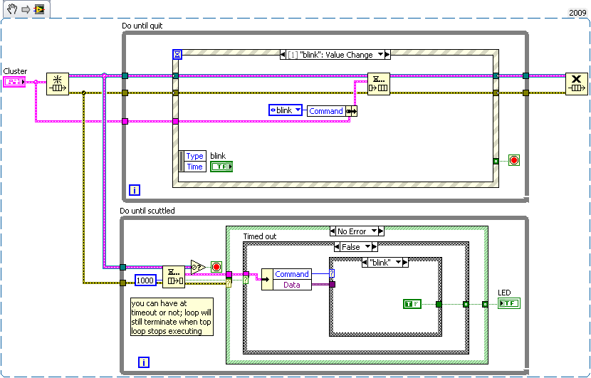

Use more than one thread. Have the event loop throw messages ("illuminate LEDs {2,3,4}") into a queue. In the reader (your subVi) you probably have some kind of wait, because otherwise your LEDs would be updating 100,000 times per second. Replace that wait with a Dequeue element with a timeout. LV will not use any CPU while waiting. If it times out, do whatever you were going to do before. If it doesn't time out, you have new commands from user.
The attached snippet is a sort of prototypical set-up. The top loop is the UI, the bottom loop does the work. When the top loop quits, it kills the queue, which will release the bottom loop with an error. We call this code pattern "scuttling the loop." Most of the time you want to wait with no timeout (-1) but if the loop should keep doing stuff with no new input, you will want one.
