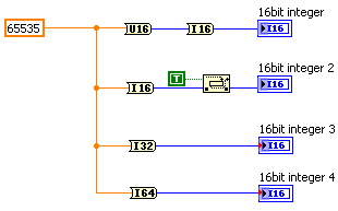

format into string 16 bit signed integer
Is there any format specifier string for "Format into string", whereas the result is an I16 string?
My problem is when I use "%d" and the input string is 65535, the result string should be "-1".

The input of the function is a DBL...

I did it... the result string is 32767 😞

Actually you need two conversions
to do that from dbl  (LabVIEW Minutea that might bite you some day:  Float to int retains sign)

Hi mitu,
then combine your approach with others shown before:

there are some other solutions, in each case the result=-1:
