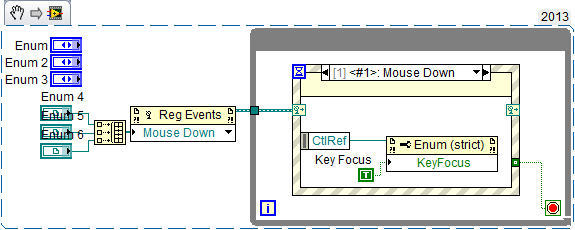

I have some form that user will fill that has many string and enum controlls, more than 40.
User wil tab and fill one by one. I want to set focus on controll when user clicks on it.
I don't want to make more than 40 event cases and service each control in separate way.
My another idea is to get refs and positions of all controls on FP, then monitor mouse click event on FP, get click position and then search for that controll.
But maybe there is more elegant way that I am not aware of ?

Hey Pawhan11,
You could place all references in an Array and register for an mouse down event. In an eventstructure use the Dynamic Event to modifyy the enum you clicked.

Thanks Member CMW..
I tried dynamic event but I registered all events in separate way  and it didn't worked  like I wanted 😄
You'r code makes it 🙂
Big thanks! , problem solved
