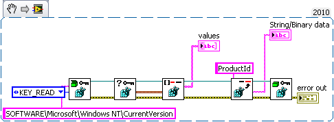

I've tried to read an entry in registry on a Windows 7. The program was written on a Windows XP with LabVIEW 2010.
It works fine on the other windows XPs but not on the Windows 7.
It always returns an error -604 , and tell me it can't find any keys when I run it on the computer.
Do I need to change the user setting in Windows 7 to do the job?

I've try another way to read the registry:
I can read all the keys now. But in the list there is no "ProductId" which is seen in Regedit and needed by me.
That's why it always returns error "-603" and tells me that the Key "ProductId" doesn't exist.
Is there a way in which I can list all the keys there?

Thanks for your advice! I've tried that but it doesn't help.
The problem is I do have any -603 error but the -604 error. That is to say one specified key cannot be found in LabVIEW, though it existes in the registry and can be found using regedit!!

I've tried the software on a windows XP with LabVIEW runtime, and it works fine.
The other computer, however, runs windows 7 with the same LabVIEW runtime (2010).
Still on the windows 7 computer it does work on the key "ProductId".
