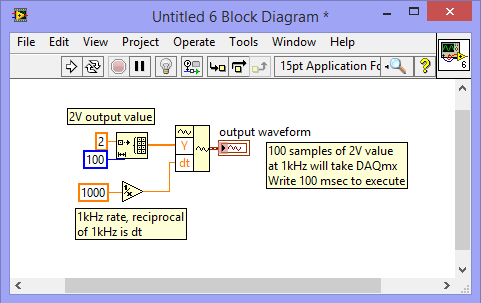

What I would suggest is that you create one task which always outputs a waveform.  When you want to output a single, constant value, instead build a waveform where all of the data elements are your constant output voltage.  Does that make sense?  Do you know about the "Build waveform" function?
Another thing you might not know...if you want to output different data for different loop iterations, you need to set up your task for non-regenerative operation.  (I'm not 100% clear on whether you'll be generating output continuously, or only in chunks.)
To specifically answer your questions, though, you cannot have two tasks that access the same resource.  You can delete and re-create the task every time you want to switch, but that's very wasteful and results in a slow memory leak.
I think you are best off adapting your single-value write to use a waveform data type.  So if you want to output, say, 2V at 1kHz, build your waveform like this:
Use that (modify as appropriate) for your single-value output.  Then use your regular waveform for your waveform output.
