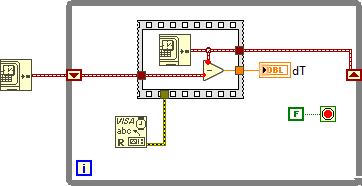

@Ezzow wrote:

I don't see from this picture where my X(i) output is? ( I'm quite new to labVIEW 🤓)
I only see how to calculate the real dT which I already did in the programm in my last reply (see attachement)

It worked perfectely with the feedback node. Many thanks @wiebe@CARYA
However, I would like to understand how you did it with the screenshot you sent 😄
