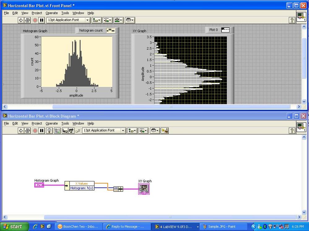

LabVIEW has this Histogram function that can help you get the normal vertical histograms. You can refer to the example finder and look for the histogram examples.
After that, to convert the normal vertical histogram to a horizontal one, you can make use of the XY-graph. Transpose the data in the vertical histogram and fit it into the XY graph. Use the Bar Plots for your plot setting. Example as follows:

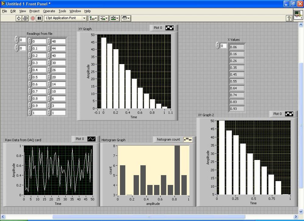

Hi Boon Chen,
Thanks for spending time to answer my question. What I needed is not to switch the histogram axis from x to y and vice versa.
Allow me to further explain what I needed actually. I have attached an example packet signals which I am going to build a cumulative histogram out of it. As realize from the graph, the total number of samples is 50 (2779 – 2729 = 50; x-axis). Assume I needed 10 classes which is divided evenly from 0 to 1 (0.1 each classes; y-axis). I have plotted out the histogram I desire using Excel. As you can see, I am actually plotting the value which is under the graph (the area under the graph). Can this be done?
Looking forward to your reply. Many thanks in advance 😃

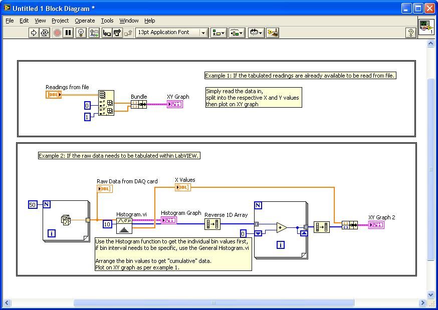

Hi Bernard,
If you already have the tabulated values readily available from a file, all you have to do is to read the data from file and plot it on a XY-graph. Refer to example 1 in the block diagram.
My suggestion on the probability functions is if you don't already have the tabulated data. I am not familiar with those probability functions, so I cannot help on the underlying theory. But in layman terms from what I understood from your attached picture, you should be able to get the desired numbers from a raw signal using the histogram function and post-processing the data in the histogram. Refer to example 2 in the block diagram.
The front panel display is as follows,
