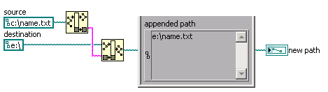

i can copy the text file let say c:\read.txt to e:\read.txt.
but i dont want the user to write the the name again
the user only can choose the directory only and save the (read.txt)
how  to do tht?

Hi jeyanthi,
Mike

thk u
Mike its works
thk u again Smiley Wink
