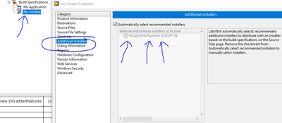

as previously mentioned you should build an installer for your application.  In the "additional installers" section, make sure the run-time engine is selected.  If your deployment machine still gives you errors after you run the installer, there is a chance one of the other run-time engine has a corrupted file.  clean the computer of all NI software and re-run your installer.
