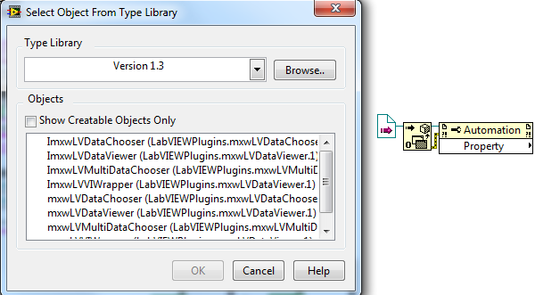

In my new project I would like to send commands to Tera Term Pro. Tera Term then responds to the commands from Labview the same way as I would type the commands directly into Tera Term.
I'm able to use cmd.exe with the SystemExecute Vi, but for my program I would like to do the same with Tera Term.
I would like to send commands with a stringcontrol and get the respond in a string indicator, all in labview. Tera Term should run invisible in the background.
So for this I thought using ActiveX would be the best. I have downloaded tera term pro.
In Labview I create this from the ActiveX Palette and select browse on the ActiveX Class.
a.png:
In the Tera Term folder I find many .dll's:
I have tried to open them all, but I only get this message:
c.png:
Does this mean it's impossible to use Tera Term with Labview like I described?

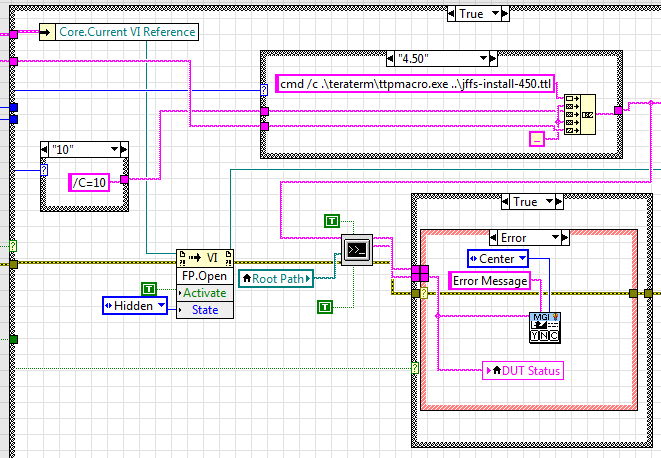

Sorry for this late reply. I have been using Teraterm Macro (not Teraterm Pro serial terminal) to interface with my previous provisioning app written in LabVIEW.
Teraterm Macro is such a lifesaver in that it can easily interface with your development boards that need: (1) RS-232C, (2) FTP, (3) TFTP or (4) SSH connections. The plain-vanilla 'serial' VI's are just that - serial port only and those need additional code to work reliably. If you need a good serial port VI try Prabhakant Patil's Hyper Terminal for LV 2009 and newer. You will find an ZIP or VIPM package from LAVA (lava.org). I have used his versions countless of times and is 10x more reliable than provided in LV examples.
You will indeed use the System-Exec.VI to call Teraterm Macro since *sigh* no one has written a wrapper for the DLLs (as you mentioned they are built for .Net framework. I have talked with the current developers and they are willing to give anyone the pass to extend Teraterm for LabVIEW so C++ devs out there with good LabVIEW knowledge should re-build the DLLs as static libraries that can be called from within LabVIEW. For now, this is the only way and it is a kludge - but it works - just not in a way you expect.
Here you can see that I am building the command line arguments before I call the system-exec node. Refer to the excellent how-to instructions at:
http://ttssh2.sourceforge.jp/manual/en/macro/commandline.html
Teraterm Macro will be spawned (opened) like it would when called from the command line. Its std input & output are not tied to your VI. You can merely pass arguments to the system-exec node. This is the reasons why we need someone to recompile the Teraterm Macro DLL as a static library (anyone?) so we can build a wrapper VI around the functions. Then its std inputs and outputs can be tied to LabVIEW's controls and indicators - hence, it becomes LV native.
